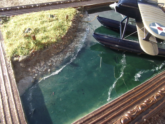

UN VIEUX CADRE DU GRENIER DU BANAL CARTON
ALORS VOUS COMMENCEZ A AVOIR UNE IDEE
L' ETANCHEITE
J'IMBIBE LE CARTON DE COLLE A BOIS LEGEREMENT DILUEE POUR FACILITER L'APPLICATION
CHANGEMENT DE TEINTE......TARDIVE
JE PEINS EN GRIS LE FOND  POUR L'EFFET PROFONDEUR
ESSAI DE POSITIONNEMENT
JE ME SUIS FAIT UNE BORDURES EN SCOTCH TRANSPARENT
J'AI REPETE L'OPERATION SUR LE DESSOUS COLLE A BOIS +PAPIER....ETANCHE LE DIO
CHEZ MEROY LERPIN CERTES C'EST PAS DONNE MAIS MOINS QUE LES PRODUITS POUR MODELISTES
UNE PREMIERE COUCHE 50/50 RESINE ET DURCISSEUR MOINS DE 20° A PLUS DE 20° C'EST 45/100
3 GOUTES DE VERT POMME UA 146 LIFE COLOR MELANGE ALEATOIRE
ZUT LE NEON.....
LA CORDE D'AMARRAGE MEME SI C'EST PAS UN BATEAU.....Very Happy
SECHAGE RAPIDE MAIS SOUS SURVEILLANCE A CAUSE DES BUBULLES
VOILA CE QUE CA DONNE
DEUXIEMME COUCHE LE LENDEMAIN MELANGE IDENTIQUE + 3 GOUTTES DE BLEU VERT MAISON
1SEA BLUE XF17+ 2 JN GREEN XF 11
UNE NUIT DE SECHAGE
JE SUIS PAS LOIN DE LA FIN LES GENS
LA PREUVE
BON ALLEZ LES FINITIONS
QUELQUES VAGUELETTES SUR LA MER....
DU SILICONE BLANC
UNE BROSSE DE 8 DIMINUEE DE MOITIE
ET VOILA
C'EST LA FINNNNNNNNNNNN !!! Sad
JE VOUS LAISSE APRECIER ..... Mad
A VOS COMS
